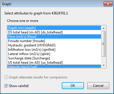

Graph Pick Selection Dialog
This dialog is displayed when viewing simulation results using the graph pick tool on the Results Toolbar . It is also displayed when viewing simulation results on the GeoPlan by right-clicking on a network object, and selecting the Graph option from the context menu.
The graph pick tool is used to display a graph of time varying data for a single network object.
The dialog offers a choice of time-varying data to graph. The list will be appropriate to the type of network object selected. More than one parameter can be selected for graphing by using the CTRL and SHIFT keys.
Note: Time-varying result attributes for 2D simulations are displayed on a 2D element basis. For subgrid 2D elements, these are shown at triangle level for depth and speed.
Enable the Show rainfall option to display rainfall results on the graph, along with the time varying parameters selected in the list.
Select the data to graph and click OK .
