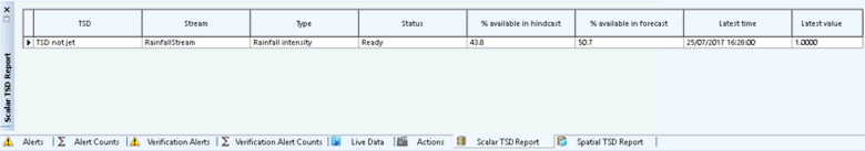

This window contains a grid which provides a summary of the Scalar Time Series Data (TSD) relevant to the simulation currently displayed in the Network page. The information in the grid is extracted from the simulation results log files.
You can use the report to assess the reliability or quality of the scalar time series data as, for example, the summary may indicate that some of the time series data may be missing. You can also set up an alert in InfoWorks ICM Ultimate or ICMLive Configuration Manager based on the information summarised in the TSD report.
To display the window, click the Scalar TSD Report tab in the middle of the Network page, or select Scalar TSD Report from the Window menu.
