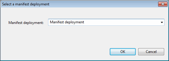

Select Manifest Deployment Dialog
This dialog is displayed when the Select manifest deployment option is selected from the File menu.
It lets you choose a manifest deployment, which is the first step in the use of ICMLive Operator Client, and displays the Overview page.
Select a Manifest Deployment dialog
Dialog description
Option
Description
Manifest deployment
Dropdown list containing the available manifest deployments.
Manifest deployment objects are configured in InfoWorks ICM Ultimate and ICMLive Configuration Manager. See the InfoWorks ICM help for more information.
OK
Opens the Overview page for the selected manifest deployment closes the dialog.
Cancel
Aborts the selection operation and closes the dialog.
