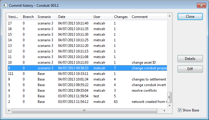

Commit History Dialog
This dialog shows the history of changes to a single network object, that have been committed to the database in InfoWorks ICM Ultimate or ICMLive Configuration Manager.
Example of Commit History dialog
The dialog is displayed when you click (Commit History) in the object's Object Properties Window toolbar.
Click Close when you have finished using the dialog.
