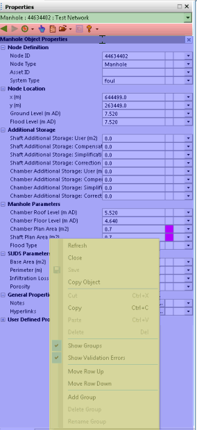

The OPW behaves like all other windows in ICMLive Operator Client. See Windows and Using Dockable Windows for details. In the following screenshot, the window components have been highlighted in different colours for a better visual effect, and are described in detail in the sections below.
Green - DropTree
Red - Toolbar
Blue - Caption Bar + Properties
Yellow - Context Menu

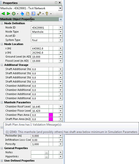

Validation |
Validation errors are displayed against each property by default. A coloured icon indicates if the object property has a validation error or warning (If the cell is empty, there is no validation error or warning). Hovering over a validation icon with the mouse will display a tooltip with details about the validation error, such as the name of the network object where the anomaly occurred as well as the cause of the error/warning. See Tooltips section below for further details. It is possible to hide the validation messages on the OPW (See Object Properties Window Settings dialog for more details). |

When some areas of the OPW (e.g. DropTree, property, validation error) are hovered over with the mouse, a non-editable and non-customisable tooltip with some information of the item being hovered gets displayed.
Example of property tooltip
Example of validation error tooltip

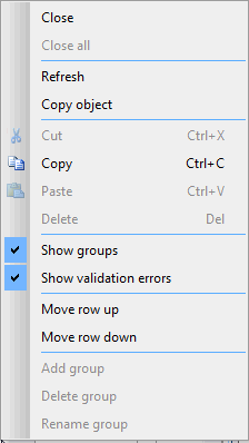

Example of Context menu
When you right-click on a group, a property, a value, an error message or a flag on the OPW, a context menu like the one shown above is displayed, allowing you to perform a large variety of tasks.
Depending on which item is clicked, or which view of the OPW is displayed (network object properties, results properties or object type layout), some of the options may be disabled. See Using the Object Properties Window for more details on each of the available options on the context menu.
