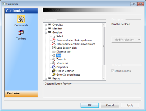

Customise - Commands Page
This page of the Customise dialog displays the toolbar buttons that are available and allows the contents of any toolbar to be changed. The appearance of toolbar buttons can also be modified using from this page.
Setting toolbar visibility and creating new toolbars is carried out using the Toolbars page of the Customise dialog.
Customize dialog- Commands page
Commands
Displays a list of ICMLive Operator Client toolbars and corresponding buttons.
To open or close a toolbar group, click the or symbols to the left of the toolbar name or double-click on the toolbar name.
To add a button to a toolbar, drag the button from the Commands box onto the toolbar at the required position.
Description
Displays a description of the currently selected button. This text will appear on the status line when the mouse pointer is placed over the button.
Modify selection
Enabled when a toolbar button (outside of the Customise dialog) is selected. Click this button to adjust the appearance of the icon. The options available are:
  • Delete - removes the button from the toolbar
  • Button Appearance - displays the Button Appearance dialog, allowing the image and text associated with the image to be changed
  • Image Only - displays the toolbar icon only
  • Image and Text - displays both the toolbar icon and the text associated with the icon
  • Put Separator Before - adds a dividing line in front of the currently selected icon
  • Put Separator After - adds a dividing line after the currently selected icon
Icons in menu
Not currently used.
Custom Button Preview
Displays a preview of the button appearance when a button from the Custom Buttons group in the Commands box is selected.
