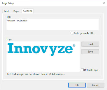

This dialog is used to set the title and logo options when printing from the
GeoPlan Window.
To display the dialog, select Page setup from the File menu.
Title options
A user defined or automatically generated title can be included at the bottom of the printout:
- Check Auto generate title to use a title generated by
ICMLive Operator Client. An existing title in the Title text box will be overwritten by the generated title.
- To edit the title, uncheck the Auto generate title box and edit the title in the text box.
Logo options
The logo is a piece of Rich Text Format text that can be included at the bottom of the printout:
- Click Load to load an existing Rich Text (.rtf) file created in an external package such as Microsoft Word.
- Alternatively paste text or images into the logo box and then click Save to save the image as a Rich Text file.
- Check Default Logo to use the default logo set in
InfoWorks ICM Ultimate or
ICMLive Configuration Manager.
