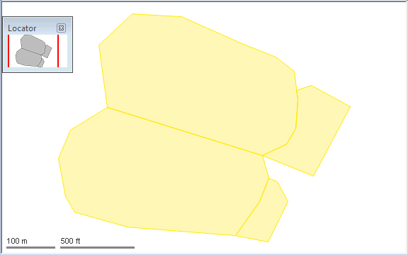

The Overview Page GeoPlan window displays a view with polygons representing areas of interest (AOI) within InfoWorks networks. These polygons will have been defined in InfoWorks ICM Ultimate or ICMLive Configuration Manager in a selection list, which is part of the Manifest database object. If no selection list has been specified then the default polygon automatically generated from network extents will be used.
GeoPlan in Overview page
The map displays a polygon for each area of interest generated from network extents.
Click a polygon using the Open associated item Open associated item tool to display the Network View for the area of interest associated with the polygon.

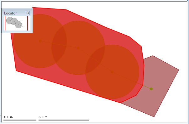

The Network Page GeoPlan window displays a detailed map of the network objects belonging to an individual area of interest. All network objects are displayed in the GeoPlan Window.
GeoPlan in Network page
Click an object in the map view to select the object. Hold the CTRL key to select multiple objects.
