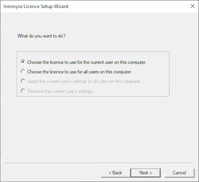

This page is used as part of the process of selecting the licence to be used by users on a client PC.
It is displayed when the Select a licence to use with the software option is selected on the Welcome Page of the licence setup wizard.
The options on the page are:
Current user settings will take precedence over settings for all users.
Setting licence options for the current user is sufficient for running the desktop software, but is not sufficient for running InfoAsset Mobile services.
Licence Setup Wizard - Action page
Setting the licence for the current user / all users
To set the licence to be used for the current user only, select the Choose the licence to use for the current user on this computer option.
To set the licence to be used for all users, select the Choose the licence to use for all users on this computer option.
Click Next. The Settings Page is displayed.
