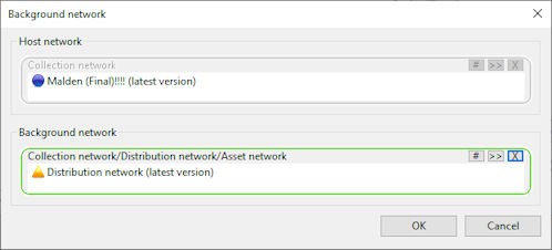

This dialog is used to select a background network on the GeoPlan window in conjunction with the current network:
A background network can also be loaded into the GeoPlan by dragging the network from the Explorer Window tree into the GeoPlan window. However, this will only display the latest version of the network; it is not possible to select a previous version in this way.
To open the dialog, select Background network from the Network menu.
The current network will be displayed in the Host network section of the dialog. Browse for a background network in the current database or drag in a network from a Guest Database.
To select an earlier version of the InfoWorks ICM network, click to display the Select Commit dialog. Select the version required and click OK.
