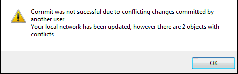

If conflicts occur when you get other users' changes, your local database will be updated and you will see a message showing you how many objects have conflicts.
Conflicts Message
Example of warning message displayed when there are conflicts
  1. Click OK and you will see the Resolve Update Conflicts dialog. This dialog displays the conflicts for one object. You can scroll through the list of objects with conflicts and resolve conflicts for each object in turn. The object you are currently resolving is highlighted on the Grid Windows and GeoPlan.
