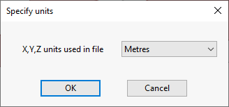

Specify Units Dialog
This dialog is displayed when importing a TIN ground model from Arc/Info TIN, Esri Shape, 12DA or XPTIN file format:
The items contained in the dialog are described below:
Item Description
X,Y,Z units used in file
A dropdown list from which you can select the type of units used in the file being imported.
OK
Confirms the choice of units in the X,Y,Z units used in the file field, and closes the dialog.
Cancel Cancels the operation and closes the dialog.
