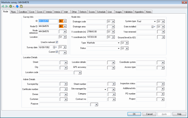

A key part of field data collection for Sewer networks is the Manhole Inspection survey. Manhole properties are recorded along with details of the pipes that enter or leave the manhole. This information is then collected together to form a representation of the sewer network. It is important to note that this survey information (by the nature of its collection method) is focussed on the manholes and not the pipes.
For purposes of understanding the connectivity of the sewer network, InfoAsset Manager Network data is not organised solely around manholes and treats manholes (nodes) and pipes on an equal footing as elements of the network. Although each manhole need be surveyed only once, each pipe is usually recorded on two manhole surveys. This requires information from multiple manhole inspections to be merged to produce pipe information. In addition to this additional surveys will be carried out for a number of reasons, including condition monitoring or error checking.
To reflect the way in which raw data is collected, InfoAsset Manager allows raw manhole survey data to be stored in Manhole Survey objects. This data may be imported into InfoAsset Manager using the generic CSV or GIS importers or specific manhole database importers e.g. STC25 Import. Any field survey collection system should be easily convertible to use one of these mechanisms.

The Defects Page on the Manhole Survey Property Sheet allows detailed defect information to be viewed, with integrated digital photo and video support.

Once a survey’s data has been incorporated into the network, its "used in network" field is set to allow the user to distinguish between newly added surveys and those that have already been processed. By this approach, InfoAsset Manager provides an audit trail of all the collected survey data, alongside an up to date interpretation of the data in the network. The user can easily identify which survey data is associated with a node using the Navigate option from the property sheet, which opens the relevant survey property sheet.
There may be many surveys available, in which case the user will be given a choice of which survey to view.
Surveys can also be viewed in Grid form as usual.
