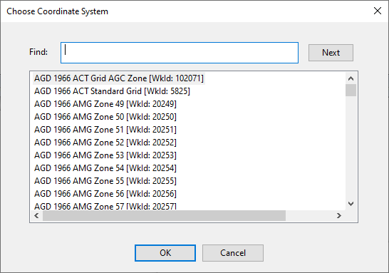

Choose Coordinate System Dialog
This dialog is used to:

Choose Coordinate System Dialog for MapXtreme

Change the projection system for a MapXtreme shape file layer
  1. Select the layer of interest in the GIS Layer Control dialog.
  2. Click Ellipsis button located adjacent to the Projection box. The Choose Coordinate System dialog is displayed.
  3. Select the desired projection system and click OK.
  4. The following warning message may be displayed to let you know that changes will be applied immediately :
  5. Warning message
  6. Click Yes to continue. The new selected coordinate system is applied to the layer and appears in the Projection box.
  7. Or click No to abort and close the dialog. The projection system has not been changed for the layer.
