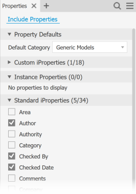

As a manufacturer of products used in the AEC industry you may want to include various properties in your exported RVT models that are used in Revit schedules. The Include Properties command provides access to and selection of the properties you can export in the RVT file. The property selection persists with the Inventor file.
With the Include Properties command there are four groups from which you can include any number of properties:
For each property group, the properties are collected from all parts and assemblies in the active file and presented in alphabetical order. You select the properties you want included in the export.
Property Group labels display the number of properties selected for export with the total number of properties available for export. For example, Custom iProperties (3/18) denotes 3 selected properties from an available list of 18 custom iProperties.
Individual properties display the number of instances where the property is used.
You can specify a Default (Revit) Category to apply to all components that are assigned <None> for their Revit Category iProperty.
