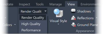

Three visual presets provide a means of quickly changing model view display.
What's New: 2021
The fixed visual presets are composed of various application options, lighting style, and scene settings. The presets are accessed from the ribbon View tab
Appearance panel:
Fixed Presets
When you change the view orientation, from the camera preset orientation, a new session entry Visual Presets is created. It is there to let you know you have left the preset camera orientation. The setting is session based and temporary.

The following explains the values each preset uses:
The Render Quality preset is best for the highest quality viewing and scene rendering.
The High Quality Preset is defined to provide a good visual experience for modeling tasks.
The Performance preset is the default for assembly models.
