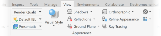

You can override view elements temporarily by using the controls on the ribbon View tab, in the Appearance panel. Changes from the ribbon temporarily override the scene elements, and are not stored with the document or application appearance settings.
View effect settings access points are at the bottom of each list, such as lighting styles, shadows, and so on. Click Settings... to launch the document-based dialog box for that view effect. Your modifications appear in the document immediately and persist when you save the settings.
