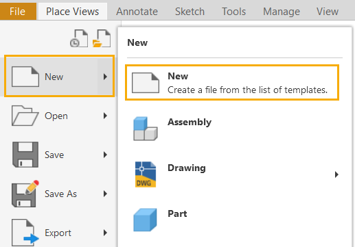

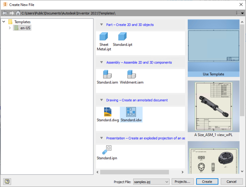

From File New: | In the Create New File dialog box, click to make a selection in the column on the right. To open the standard.idw (Use Template), click Create. You can also double-click a template to open. |

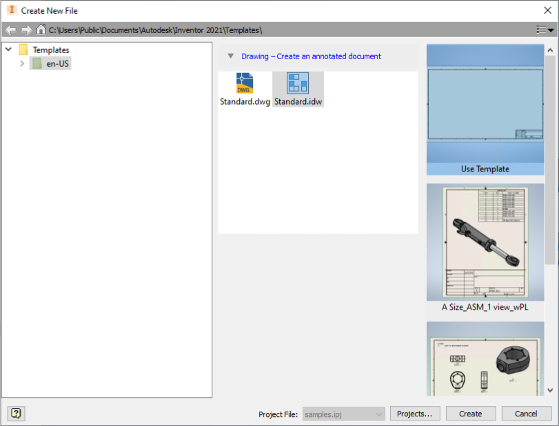

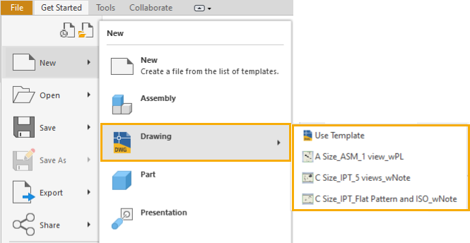

From File New Drawing: Hover over the flyout arrow to display available sheet format templates from the flyout menu, and click to make a selection. | |

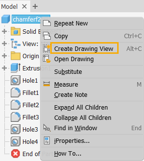

| In a part or assembly file: Right-click the file name in the browser, select Create Drawing View. The Create New File dialog box displays. | To open the standard.idw (Use Template), click Create. You can also double-click a template to open. |
