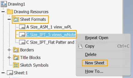

In the browser, expand Drawing Resources
Sheet Formats. Right-click on a sheet format, and select New Sheet.
In the Select Component for View on Sheet dialog box, select a model file to place views of the model in the sheet and click OK.
Select the browser node of the new sheet and enter a descriptive name.

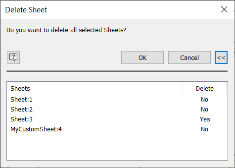

In the browser, select one or more sheets to delete.
Do one of the following:
(Optional) To change which sheets are selected for deletion, in the Delete Sheets dialog, click More
, and then click Delete to specify which sheets to delete.
Click OK to delete specified sheets.
