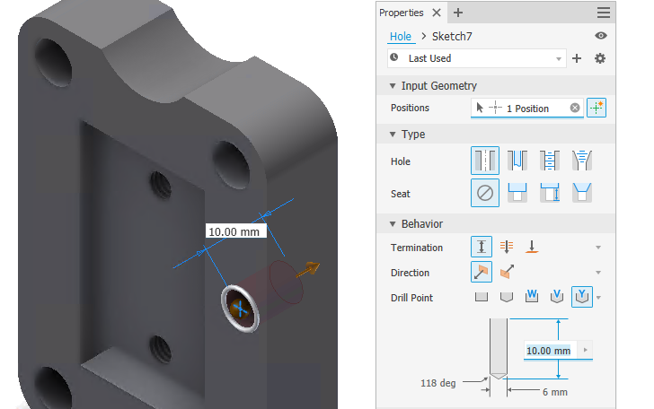

The Property Panel workflow is progressive and flows from top to bottom of the panel. Parameters in a section affect the feature and set the context for the following sections in the panel.
Property panels use a breadcrumb for steps in the process. You can click breadcrumb text to move to that step of the process. For example, during hole creation, if you click the breadcrumb "Sketch" you are placed in the sketch environment. If you click Hole, you are in the place feature environment. You can rename features and sketches through their breadcrumb.
Rename active Hole and Sketch nodes from the property panel by clicking the breadcrumb text to select it, then clicking again to edit the text.
Parameter values can be edited in the property panel, in-canvas, or by clicking-dragging the feature parameter manipulator. Active manipulators highlight in the canvas, and in the property panel the associated field has focus.
Edited values in the property panel can be committed by pressing Enter or Tab to move to the next field. Press Ctrl+Enter to create the hole and close the property panel.
Value Edit visual feedback, when a value is invalid, for example, the specified thread length is larger than hole depth, the value color turns red. When a value is valid, the value color is black.

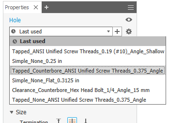

Specify a preset. If there are no presets or the preferred one doesn't exist, continue the process specifying the needed hole parameters.
Specify the Positions. An existing sketch is not required. Valid inputs for hole locations include a face, sketch point (end or mid), or work point. You can limit the selection to existing points by turning OFF the Position option
Allow Center Point Creation. The last used state the option was in is remembered for the next hole.
For example, if you toggle Allow Center Point Creation off to select line endpoints as hole positions, it remains off and does not automatically reset.
The Status bar, in the lower left corner, keeps you aware of the active command.
When Allow Center Point Creation is
Clicking a face selects the body associated to the face, creates a sketch, and places the hole center. Clicking a point places the hole center, then, you select a face, plane, or linear edge to define hole direction. Clicking a workplane creates a sketch on the plane and places a hole center.
To edit the sketch, use the breadcrumb access at the top of the property panel. If a sketch with more than one hole center is visible, all hole centers without an associated hole are selected.
Positions
Specify the hole position by:
Click a reference edge to place dimensions. Linear placement dimensions can be selected, edited, or deleted while you are in the Hole command. Select the dimension and change the value or use the Delete key to remove the dimension.
You can also click the arrow at the right end of the dimension field and choose Select Feature Dimension. Select the feature containing the dimension you want to use and then the actual dimension.
To create concentric holes, place the hole center and click the model edge or curved face the hole is to be concentric with.
To remove a hole center from the selection and retain it in the sketch, use Ctrl+click and select the hole center. To remove the hole and hole center, select and delete the hole center point.
To clear the selection, use the Clear Selection button  at the end of the selected item.
