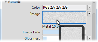

In the Appearance Browser, edit the custom appearance.
In the Appearance editor, click the Image preview to access the Texture Editor.
In the Texture Editor you can: switch images, modify the Position, Scale, and Repeat values. In this instance, Scale needs to be modified.
Click the Source name to replace the image with another.
