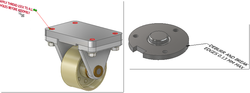

Add or edit a leader line with text
Leader Text is created with a single-segment leader by default. To create more leader segments, start the command, right-click, and click Single-Segment Leader to unselect the option.
  1. On the ribbon, click Annotate tab Notes panel Leader Text .
  2. Select the anchor point on the geometry.
  3. Optionally, right-click and do any of the following:
    • Click Change to Next Candidate Plane in the context menu or use the SPACEBAR shortcut to cycle through alternate planes.
    • Click Change Annotation Plane and then select a planar face to orient the text.
    • Click Toggle Alignment to reorient the text.
    • Click Align to Geometry in the context menu and then select an edge or axis to orient the text.
    • Click Add Vertex to include an additional vertex in the leader, providing more flexibility for the leader shape.
    • Click Delete Vertex to remove vertices that were added to the leader.
    • Click Add/Remove Associated Geometry and then select the geometry you want to associate with the leader text.
      Tip: You can use window select to add or remove geometry. After creation, highlight the leader line to view the associated geometry.
  4. Click to place the leader endpoint.
  5. Add the desired text in the Format Text dialog box and then click OK or Apply to create.
  6. To edit leader text do one of the following:
    • Select the leader in the display or browser, right-click, and select Edit in the context menu.
    • Double-click the leader in the display or browser.
      Change the required values, add or remove associated geometry, and then click OK.

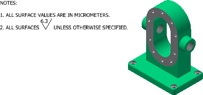

Add a General Note
  1. On the ribbon, click Annotate tab Notes panel General Note .
  2. Select the quadrant in the display to place the note.
  3. Add the desired text in the Format Text dialog box.
  4. If desired, click the Insert Surface Texture icon to add a general surface texture to the note.
    You can also click to add a general profile to the General Note.
  5. Click OK or Apply to create.
    The note is displayed normal to the view.
