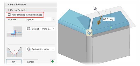

Flanges that share a common corner automatically show a full or partial miter.
Flange miters are created when the selected edges are both coplanar and nonparallel.
If the flange extents are close enough (depending upon the miter-gap), a full corner is created.
If the flanges intersect, a partial miter is created.
If the edges meet at common bend so that all three bends face inwards, a three-corner bend is created.
Flanges that are not coplanar also auto-miter.
If adjacent flanges do not preview with miter corners, verify that Auto-Mitering is selected on the Flange property panel, in the Corner Defaults section.

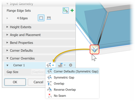

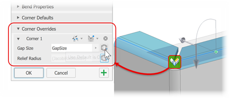

Clicking on the corner glyph displays the Corner Override group in the property panel. Click the Use Defaults button to toggle on or off the use of corner default settings.
Click the Gap or Corner Defaults buttons to access the various options
