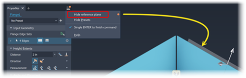

Tip: In some cases, a flange can merge into an existing face.
If the faces merge, try using an offset plane to define the flange.

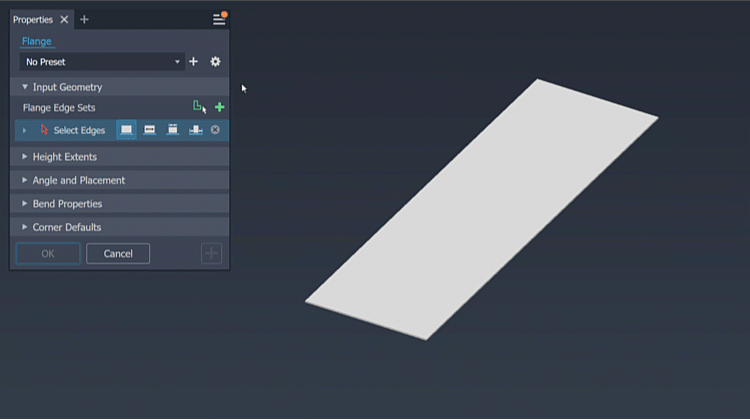

  1. On the ribbon, click Sheet Metal tab Create panel Flange .
  2. (Optional) Use a preset that you have created from a previous flange feature.

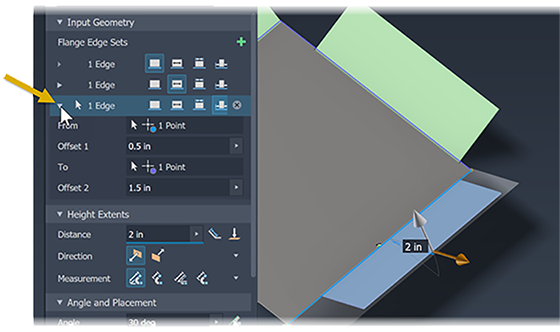

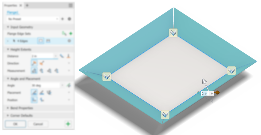

  3. Input Geometry group in Flange Edge Sets, do one of the following:
    • Edge Select Mode is active by default, select one or more edges on which to create flanges.
    • To create multiple flanges around an edge loop, click Edge Loop Select Mode, and then select a loop.

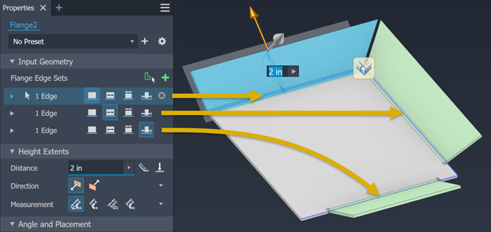

    • Edge Sets consist of one or more edges. Each edge set in the feature has per edge parameters and feature parameters (these are height, angle, and width). For Loop edge sets, all edges use the same edge parameters.
      1. Expand a set and the edges comprising the set to access their parameters.
      2. Select the edge option to use, choose from Edge, Width, Between, and Offset. Then, expand the edge row to expose the parameters for modification.
        Note: As you change the flange edge option, additional input controls for the type are exposed allowing for greater control of the flange output.
      3. Use the feature manipulators to implicitly adjust the flange angle and height. Clicking a manipulator displays a canvas input field that you can use to explicitly specify a value or you can specify the values in the property panel.

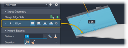

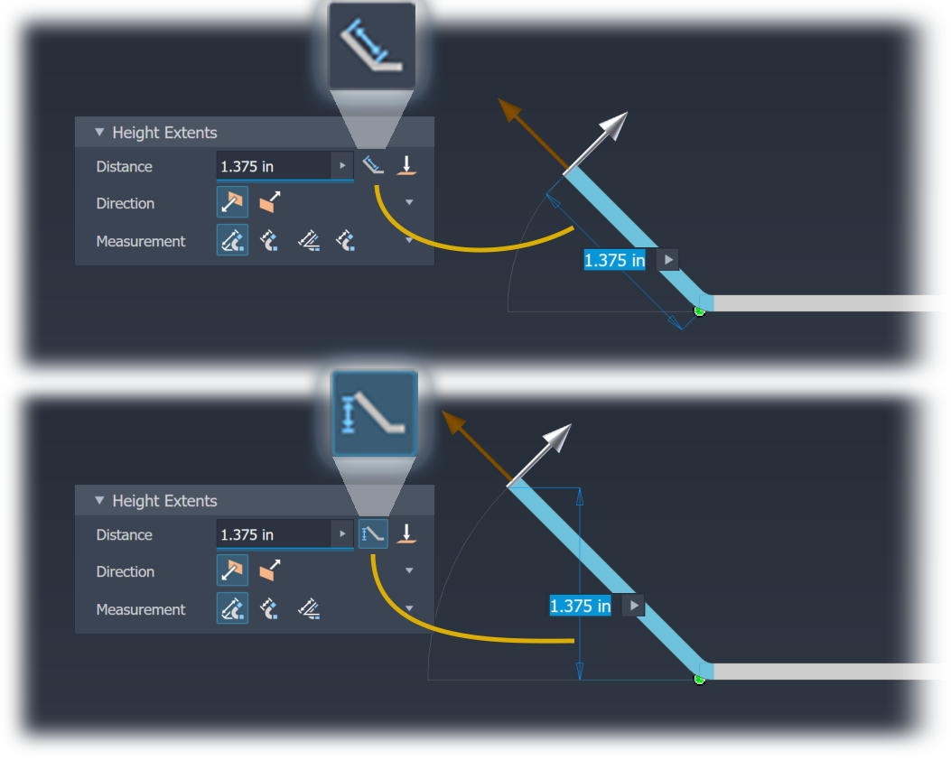

  4. In the Height Extents group, you can do the following:
    • Click in the Distance field and enter a value.
    • Select Aligned (default) or Orthogonal to have the distance apply to the edge direction.
    • Select To and specify a vertex (point) that defines the flange height.
    • For Direction, select the side of the sheet metal face that the flange is on.
    • For Measurement, select the measurement method, choose from the intersection of the two outer faces, the intersection of the two inner faces, from a selected edge, or from a tangent plane.

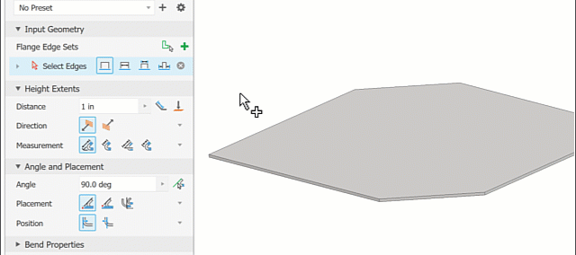

  5. In the Angle and Placement group, specify the following:
    • Enter the angle value. The field accepts numeric entries, formulas, parameters, or measured values.
    • Set the Flange Angle option to By Reference and select a face to create a coplanar flange. The adjacent flange length adjusts to enable the coplanar condition.
    • If you do not want the outside face of the bend to align to the selected edge, specify the bend position relative to the selected edge.

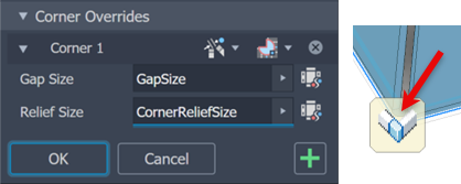

  7. In the Corner Defaults group, you set the Auto-mitering option, the Corner Shape, and Corner Relief. Select corner options from the corresponding list.
  8. In the canvas, for multi-edge flanges, you can specify individual corner parameters by means of Corner Overrides. Click a corner glyph to populate the corner in the property panel. Then, modify the corner settings for relief, shape, gap size, and relief size to fit your requirements.
    To enable gap and relief size fields, click the defaults icon next to the field.

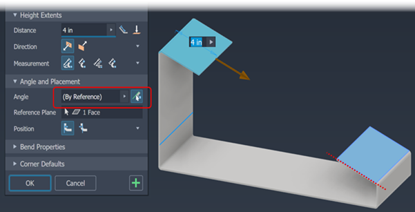

  2. Edge Select Mode is active by default, select an edge.
  3. In the Height Extents drop-down list, do one of the following:
    • For Distance and enter a value in the drop-down list below it.
    • Select To and specify a geometry that defines the flange height.
    • Modify Direction and Measurement settings to meet your requirements.
    • To change the side of the sheet metal face that the flange is on, click Flipped.
  4. In Angle and Placement, for Angle, specify the following:
    • Set the Flange Angle option to By Reference to match the angle of the selected planar face, planar surface, origin plane, or work plane.
    • Select the reference face or plane.
    • Set the Bend Position to Inside of Reference Plane, or Outside of Reference plane.
    • Specify the Bend Radius or accept the default BendRadius parameter.
    • If not the intersection of the two outer faces, specify the datum from which to measure the height.
  5. To continue adding flanges, click Apply. To end flange creation, click OK.

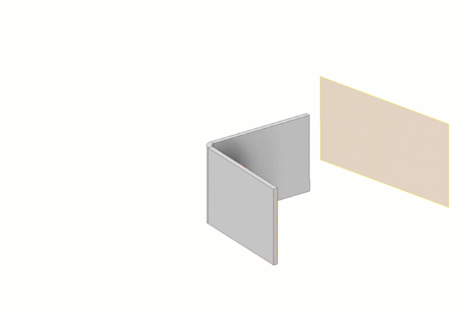

Create Symmetrical Flanges Using Mirror
One method of creating identical symmetrical flanges is by using the Mirror command.
  1. Start by creating a Face symmetrical about the Origin planes or work planes.
  2. Create the flanges and other features to mirror.
  3. Start the Mirror command. Select all the features that you want to mirror, select the mirror plane, and then click OK to finish.
  4. Create the next set of flanges and other features to mirror.
  5. Start the Mirror command. Select all the features that you want to mirror, select the mirror plane, and then click OK to finish.
Turn off the visibility of the mirror planes when you finish.
