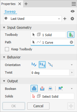

Sweep a Toolbody Along a Path
You can use solid sweep to create complex shapes, simulate toolpaths, or to design timing screws. The toolbody is not required to be a revolved or cylindrical body.
Following are some tips for a successful solid sweep:
Note: See the guided tutorial Create a slide with Solid Sweep to learn more.
  1. Before you start the command:
    • Create the base solid.
    • Create the sweep path.
    • Create the solid toolbody, preferably at the start of the sweep path.
  2. Click 3D Model tab Create panel Sweep .
    If required, enable the Solid Sweep option in the property panel.
  3. (Optional) Select Keep Toolbody.
    Keep Toolbody retains the toolbody used in the operation as an independent body. The visibility is turned off after the operation. If not selected, the toolbody is consumed and can’t be used for more operations.
    Tip: Select the Visibility toggle button to keep the toolbody solids visible for the next selection.
  4. Select a Curve or an Edge to define the Path.
  5. Choose an Orientation:
    • Follow Path
    • Fixed
    • Aligned
  6. If using the Aligned option, select the axial direction Vector.
  7. If required, specify the Twist angle. The Twist angle is related to the toolbody, not 3D space.
    If required, select the Twist Axis.
    The following image shows the effect of a 90 degree Twist angle in an Aligned sweep. The twist angle applied to the toolbody creates a design that can rotate a bottle from horizontal to vertical along the path.
    (Model credit: Scott Moyse)
  8. Specify an Output operation:
    Note: The default output with zero or one solid in the model is New Solid. The Output section of the property panel will not display. When there is more than one solid in the model, the following options are presented:
    • Join. Adds the volume created by the swept feature to another feature or body. Not available in the assembly environment.
    • Cut. Removes the volume created by the swept feature from another feature or body.
    • Intersect. Creates a feature from the shared volume of the swept feature and another feature. Deletes material that is not included in the shared volume. Not available in the assembly environment.
    • New Solid. Creates a solid body. Each solid body is an independent collection of features separate from other bodies. A body can share features with other bodies. If desired, rename the body.
  9. Click Ok.

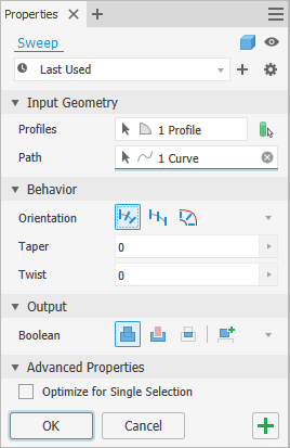

Sweep a Profile Along a Path
  1. Sketch a profile and path on intersecting planes. The path must pierce the profile plane. The start point must be located on the intersection of the planes for profile and path.
    If there is only one profile in the sketch, it highlights automatically. Otherwise, select a sketch profile.
  3. In the Sweep dialog box, click Profile and then select the profile to sweep.
    Tip: When making multiple profile selections, to prevent automatic advance to the next selector, clear the check box for Optimize for Single Selection.
  4. With the Path selection tool, select a 2D sketch, 3D sketch, or edges of geometry.
    Note: If using edges for the path, when the sweep command is completed, the edges project to a new 3D sketch.
  5. If there are multiple solid bodies, click Solids and then select the participating bodies.
  6. Specify the Output type:
    • Solid. Creates a solid feature from an open or closed profile. Open profile selection is not available for base features.
    • Surface. Creates a surface feature from an open or closed profile. Functions as a construction surface on which to terminate other features, or a split tool to create a split part, or split a part into multiple bodies. Surface selection is not available for assembly extrusions or primitives.
  7. Choose Type Path.
  8. Choose an Orientation:
    • Path. Holds the swept profile constant to the sweep path. All sweep sections maintain the original profile relationship to the path.
    • Parallel. Holds the swept profile parallel to the original profile.
  9. For a path sweep oriented to a path, specify Taper and Twist angles.
    A positive taper angle increases the section area as the sweep moves away from the start point.
    A negative taper angle decreases the section area as the sweep moves away from the start point.
    With nested profiles, the sign (positive or negative) of the taper angle is applied to the outer loop of nested profiles; inner loops have the opposite sign.
  10. Specify an Operation:
  11. Click Ok or Apply to continue to use the Sweep command.
    Note: Use the Advanced Setting option Keep sketch visible on (+) to continue to use the path sketch for additional sweep features.
