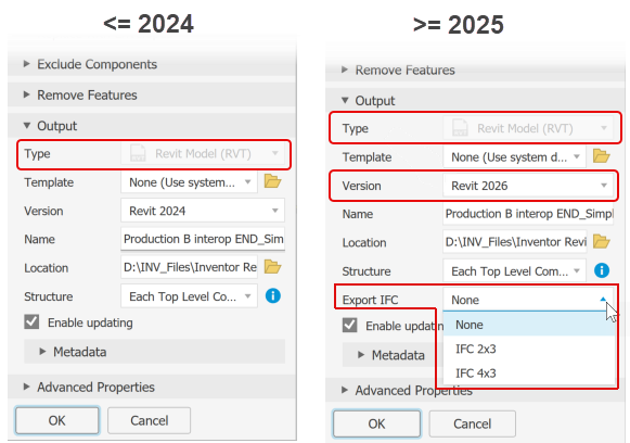

Simplify & Export expedites the process by pre-defining the Simplify output as only an RVT file. You can export to previous releases. For releases 2025 and newer, you can also export an IFC file if needed.
See the To Export a Model to RVT (Revit format) for the steps to output a simplified RVT model.
