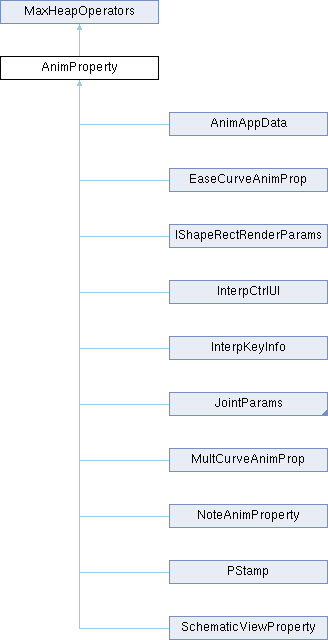

Inheritance diagram for AnimProperty:

This is the base class for classes that can be hung off an animatable's property list. When an animatable is deleted, its properties will be deleted and their virtual destructor will be called.

Implemented in AnimAppData, EaseCurveAnimProp, InterpCtrlUI, InterpKeyInfo, IShapeRectRenderParams, JointParams, MultCurveAnimProp, NoteAnimProperty, and SchematicViewProperty.
