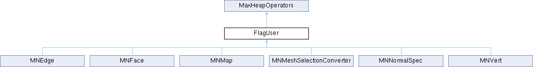

FlagUser Class Reference
#include <C:/adskgit/3dsmax/3dsmax/3dswin/src/maxsdk/include/mncommon.h>
Inheritance diagram for FlagUser:

Detailed Description
See also
Class MNMesh.
Description:
This is a handy class to subclass off of when you're designing a class with flags. It contains one private data member, a DWORD, with the flag info. It then implements a bunch of handy flag-related functions. All methods of this class are implemented by the system.
