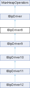

IBipDriver8 Class Referenceabstract
Interface into the biped driver controller for Max 8. More...
#include <C:/adskgit/3dsmax/3dsmax/3dswin/src/maxsdk/include/CS/Biped8Api.h>
Inheritance diagram for IBipDriver8:
