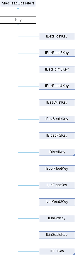

Inheritance diagram for IKey:

Detailed Description
See also
Class IKeyControl, Class Animatable.
Description:
This is the base class for keys that are part of the controller interface. This class stores the time of the key, and some flags that describe the properties of the key.
