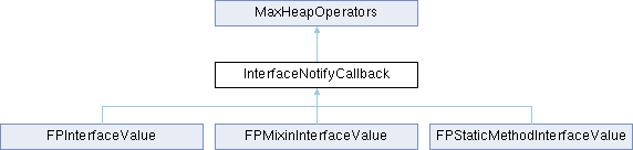

Inheritance diagram for InterfaceNotifyCallback:

Reimplemented in FPInterfaceValue, FPMixinInterfaceValue, and FPStaticMethodInterfaceValue.
