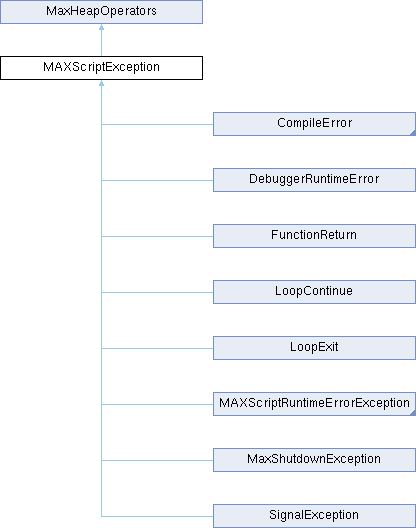

MAXScriptException Class Reference
#include <C:/adskgit/3dsmax/3dsmax/3dswin/src/maxsdk/include/maxscript/kernel/exceptions.h>
Inheritance diagram for MAXScriptException:
Classes
class  ScopedCplusplusCallstackCaptureDisable
 helper class for disabling c++ callstack capture if a system exception is thrown. More...
class  ScopedMXSCallstackCaptureDisable
 helper class for disabling mxs callstack capture if an exception is thrown. More...
