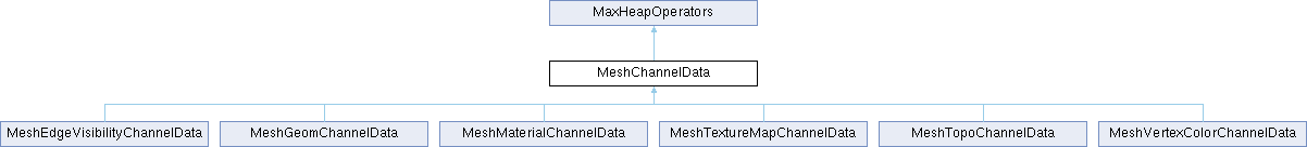

Inheritance diagram for MeshChannelData:
