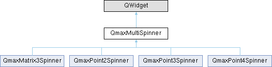

| QmaxMultiSpinner (int numSpinners, int numCols, QWidget *parent=nullptr) | |
| Constructs a multi-spinner control with a predefined number of spinners. | |

Implemented in QmaxMatrix3Spinner, QmaxPoint2Spinner, QmaxPoint3Spinner, and QmaxPoint4Spinner.
