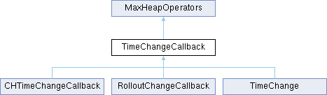

Inheritance diagram for TimeChangeCallback:
