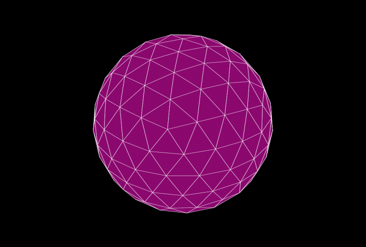

)Let us test the changes to the script on the same examples as in Part 1 to see the difference.

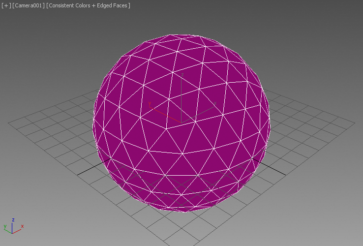

As you can see, the problems at the edges of the Geosphere have been solved by the new sorted drawing approach.
It matches the results seen in the viewport using "Consistent Colors + Edged Faces" drawing mode pretty closely.

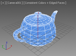

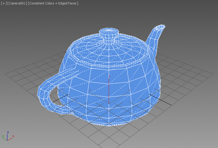

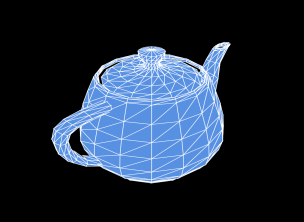

Let us increase the Stroke Thickness to 2 and render the Teapot primitive from the Part 1:
Let us resize the viewport and look at the result:

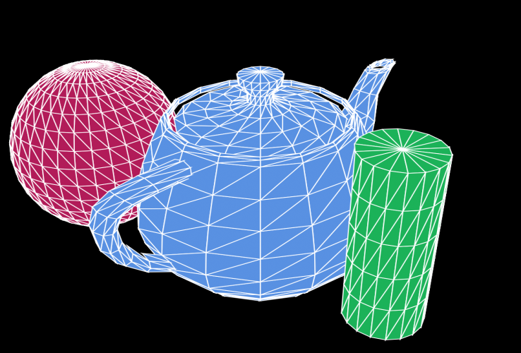

Rendering the problematic setup from the first part also produces correct results now:
Because we are culling the backfaces, it is possible to see the Sphere through the gap between the Teapot's Body and Lid.
