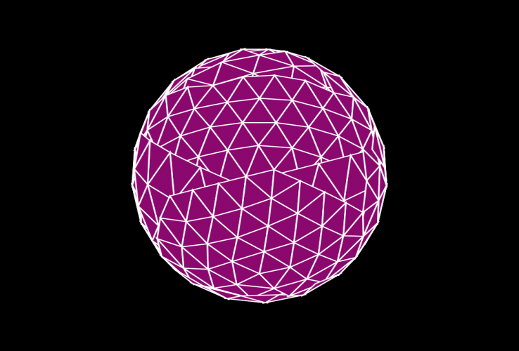

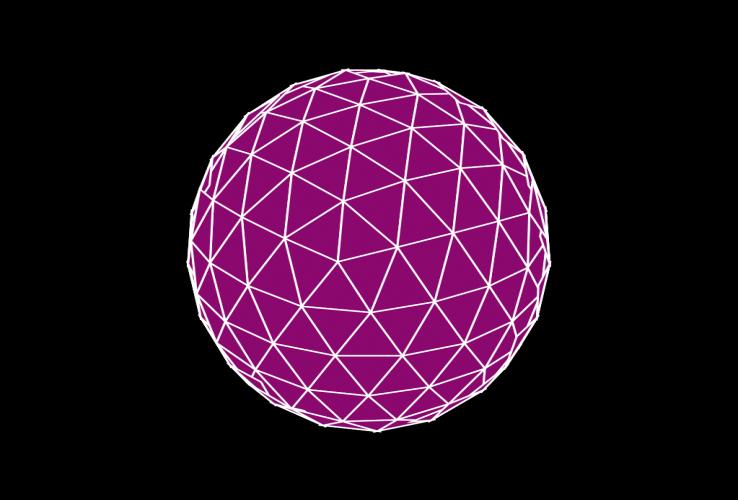

        if (theNormal*theViewTM).z > 0 do
        (We want to make sure we only draw faces whose normals are pointing at the camera (also known as Backface Culling).
To do this, we multiply the Normal which was originally in World Space by the View Transformation Matrix (the one with Translation part set to zero). This converts the Normal into View space.
At this point, since the view is looking at the scene along its -Z axis, any Z values that are negative are parallel to the viewing direction (facing away from the viewer), while positive Z values mean "facing the viewer".
There are still some problems at the edges of the Geosphere because there is no sorting by depth (we will add this in Part 2).

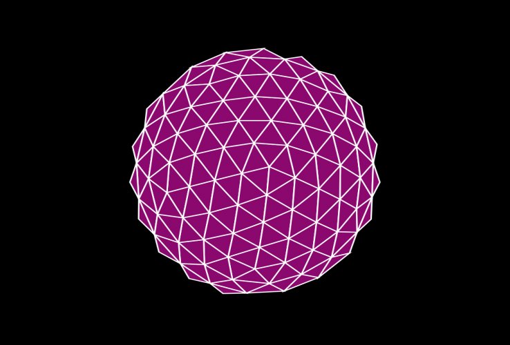

Inverting the test to if (theNormal*theViewTM).z < 0 do will cull the front faces and only draw the backfaces:
Without this test, ALL faces of the mesh would be drawn, and since we are not performing any other sorting yet, the result would be very messy:

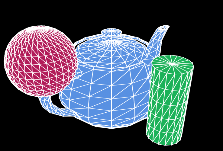

Let's try to render some geometry primitives through a Perspective viewport.
As you can see, the Teapot which consists of 4 elements - Body, Lid, Handle and Spout - has severe sorting problems - the Spout is partially drawn over the Body.
A similar problem occurs when rendering multiple individual objects depending on the position of the camera and the order of creation.
In the following example, the Cylinder was created second after the Teapot, while the Sphere which is in fact located behind the Teapot, was created third:
In the second part of the tutorial, we will sort the polygons to avoid incorrect overlapping within a single object and between multiple objects to fix the problems illustrated above.
