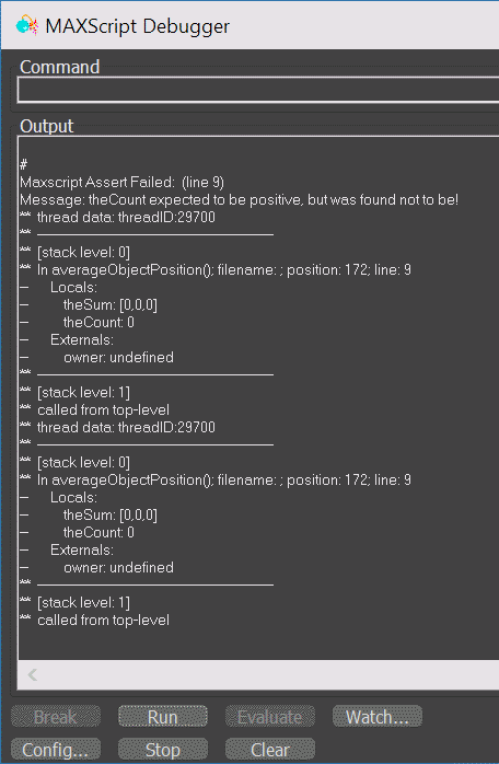

The developer has opted to include an assert() call, which postulates that theCount is expected to be always greater than zero and if that is not the case, the execution of the code will break in the debugger and will show the stack in the Listener.
In this example, this is done for demonstration and to illustrate how the assert() function works.
In real world, the assert() would be typically used to ensure the correctness of values going through much more complex calculations where catching irregularities with IF tests would be difficult because the developer cannot anticipate what can be the possible cases to test. In addition, the assert() has several report modes that could be useful (like breaking in the C++ Debugger when running a Debug build of 3ds Max).
If the above function is executed with an empty scene, the result would be

"Assert - Expected "defined", got undefined - (C:\Temp\TestAsserts.ms) in frame TestAsserts, at line 18"
"Assert - Expected undefined, got 1.0 - (C:\Temp\TestAsserts.ms) in frame TestAsserts, at line 19"
"Assert - Expected 1.1, got 1.0 - (C:\Temp\TestAsserts.ms) in frame TestAsserts, at line 20"
"Assert - Expected "Python", got "MAXScript" - (C:\Temp\TestAsserts.ms) in frame TestAsserts, at line 22"
"Assert - MAXScript is usually case-insensitive, but this assert isn't! - Expected "maxscript", got "MAXScript" (C:\Temp\TestAsserts.ms) in frame TestAsserts, at line 23"
"Assert - Expected [1,2,3.1], got [1,2,3] - (C:\Temp\TestAsserts.ms) in frame TestAsserts, at line 24"
"Assert - Expected (matrix3 [1,0,0] [0,1,0] [0,0,1] [0,0,0]), got (matrix3 [1,0,0] [0,1,0] [0,0,1] [100,200,-300]) - (C:\Temp\TestAsserts.ms) in frame TestAsserts, at line 26"
"FloatVariable seems to be positive, I am upset!"
"Nothing Really Worked!"
"Asserts Demo End."
--User Data:
"Tested Values Were:undefined,true,false,1.0,MAXScript,[1,2,3],(matrix3 [1,0,0] [0,1,0] [0,0,1] [100,200,-300])"
--Failures: 11
"Assert - Expected true, got false - (C:\Temp\TestAsserts.ms) in frame TestAsserts, at line 14"
"Assert - Expected false, got true - (C:\Temp\TestAsserts.ms) in frame TestAsserts, at line 15"
"Assert - Expected 2.0, got 1.0 - (C:\Temp\TestAsserts.ms) in frame TestAsserts, at line 16"
--Exceptions: 1
OKNote that the Assert on line 21 did not output a failure because the tolerance was set to 0.2, allowing 1.0 to pass a test against 1.1, which the Assert on the previous line 20 did not allow.
Line 23 had a custom message prepended to the default message.
Line 25 also passed due to a higher tolerance delta.
As you can see, with these assert functions you can collect data about the state of variables with various value types or the return values of expressions and collect the information in the AssertReporter to analyze after a test run of the code or dump to a log file for later processing.
