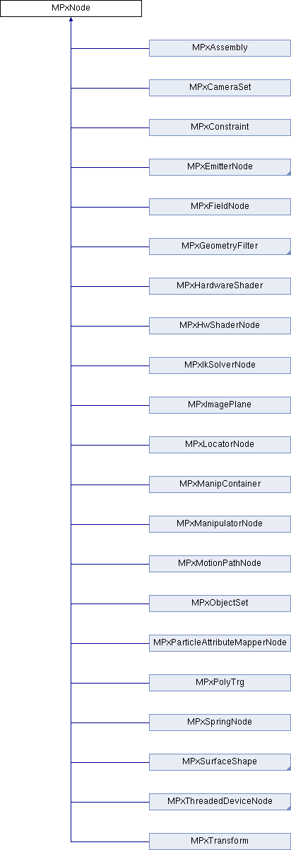

+ Inheritance diagram for MPxNode:

Base class for user defined dependency nodes.
MPxNode is the the parent class for user defined dependency nodes. A dependency node is an object that resides in the dependency graph. It computes output attributes based on a set of input attributes. When an input changes, the compute method is called for each dependent output.
The dependency graph is made up of nodes that have connections between their attributes. When an attribute changes, recomputation propagates through the graph until all affected values have been updated.

enum Type
Defines the type of node.
Enumerator
kDependNode
Custom node derived from MPxNode.
kLocatorNode
Custom locator derived from MPxLocatorNode.
kDeformerNode
Custom deformer derived from MPxDeformerNode.
kManipContainer
Custom container derived from MPxManipContainer.
kSurfaceShape
Custom shape derived from MPxSurfaceShape.
kFieldNode
Custom field derived from MPxFieldNode.
kEmitterNode
Custom emitter derived from MPxEmitterNode.
kSpringNode
Custom spring derived from MPxSpringNode.
kIkSolverNode
Custom IK solver derived from MPxIkSolverNode.
kHardwareShader
Custom shader derived from MPxHardwareShader.
kHwShaderNode
Custom shader derived from MPxHwShaderNode.
kTransformNode
Custom transform derived from MPxTransform.
kObjectSet
Custom set derived from MPxObjectSet.
kFluidEmitterNode
Custom fluid emitter derived from MpxFluidEmitterNode.
kImagePlaneNode
Custom image plane derived from MPxImagePlane.
kParticleAttributeMapperNode
Custom particle attribute mapper derived from MPxParticleAttributeMapperNode.
kCameraSetNode
Custom director derived from MPxCameraSet.
kConstraintNode
Custom constraint derived from MPxConstraint.
kManipulatorNode
Custom manipulator derived from MPxManipulatorNode.
kMotionPathNode
Custom motionPath derived from MPxMotionPathNode.
kClientDeviceNode
Custom threaded device derived from MPxThreadedDeviceNode.
kThreadedDeviceNode
Custom threaded device node.
kAssembly
Custom assembly derived from MPxAssembly.
kSkinCluster
Custom deformer derived from MPxSkinCluster.
kGeometryFilter
Custom deformer derived from MPxGeometryFilter.
kBlendShape
Custom deformer derived from MPxBlendShape.
kLast
Last value, used for counting.
