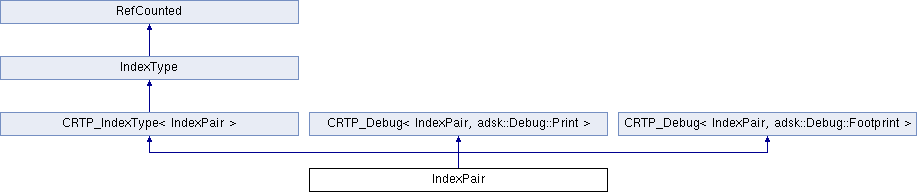

Index type which uses a pair of IndexCount values for the index mapping.
adsk::Data::Stream objects contain a list of data elements. Each element has to be accessed by Index. This is one of the more general index types, a pair of IndexCount values. An adsk::Data::IndexPair element is used to lookup the physical location of a data element, either directly in an array using the dense mode or indirectly through a mapping in the sparse, or mapping, mode.
