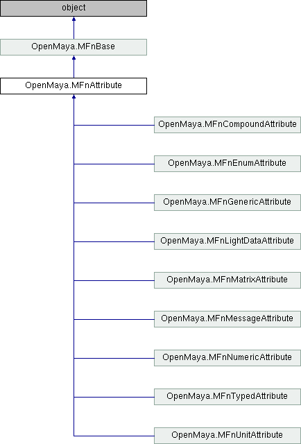

Inheritance diagram for OpenMaya.MFnAttribute:Public Member Functions | |

Base class for attribute functionsets. Method resolution order: - MFnAttribute - MFnBase - builtins.object
