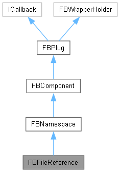

Objects Containing class. More...
#include <fbfilereference.h>

Public Member Functions inherited from FBNamespace | |

Public Member Functions inherited from FBComponent | |

Public Member Functions inherited from FBWrapperHolder | |
