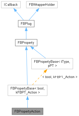

Property: Action Action property to trigger function. More...
#include <fbproperties.h>
Public Member Functions | |
| FBPropertyAction () | |
| Constructor. | |
| ~FBPropertyAction () | |
| Destructor. | |
| bool | operator() () |
| Overloaded () operator. | |
Definition at line 1311 of file fbproperties.h.
inline |
Constructor.
Definition at line 1315 of file fbproperties.h.
inline |
Destructor.
Definition at line 1318 of file fbproperties.h.
| bool operator() | ( | ) |
