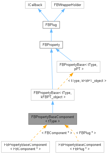

Public Member Functions | |
| FBPropertyBaseComponent () | |
| Constructor. | |
| FBPropertyBaseComponent (const FBPropertyBaseComponent< tType > &pValue) | |
| Constructor. | |
| ~FBPropertyBaseComponent () | |
| Destructor. | |
| void | operator= (tType pValue) |
| Overloaded = operator. | |
| tType | operator-> () |
| Overloaded -> operator. | |
| operator tType () const | |
| Overloaded cast to tType operator. | |

| Internal class Id. | |
Protected Attributes inherited from FBProperty | |
| FBString | mName |
| void * | mParent |
Protected Attributes inherited from FBPlug | |
| bool | mAllocated |
| Contain the Allocation State of the Component. | |
| HIObject | mObject |
| Handle on the Plug. | |
| bool | mSDKComponent |
| bool Plug is an SDK component. | |
Static Protected Attributes inherited from FBPlug | |
| static const char * | ClassGroupName |
| ClassGroupName of the object. | |
| static int | TypeInfo |
| TypeInfo. | |
| static int | mGlobalTypeInfo |
| Represente the Type Index. | |
Definition at line 1214 of file fbproperties.h.
inline |
Constructor.
Definition at line 1221 of file fbproperties.h.
inline |
Constructor.
| pValue | Value to set for component. |
Definition at line 1226 of file fbproperties.h.
References FBPropertyBase< tType, pPT >::operator=().
inline |
Destructor.
Definition at line 1231 of file fbproperties.h.
inline |
Definition at line 1250 of file fbproperties.h.
inline |
Definition at line 1245 of file fbproperties.h.
inline |
Definition at line 1239 of file fbproperties.h.
| int* TypeInfo |
< Type information.
Definition at line 1218 of file fbproperties.h.
