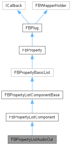

List: AudioOut More...
#include <fbaudio.h>
Public Member Functions | |
| FBAudioOut * | operator[] (int pIndex) |
| Get the audio output at pIndex. | |
