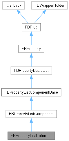

Public Member Functions | |
| virtual int | Add (FBDeformer *pItem) |
| Add a texture to the property list. | |
| FBDeformer * | operator[] (int pIndex) |
| Get the texture at a specific index. | |
