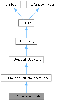

List: Model More...
#include <fbmodel.h>
Public Member Functions | |
| int | Add (FBModel *pItem) |
| Add a model to the property list. | |
| int | Remove (FBModel *pItem) |
Remove model pItem from property list. | |
| virtual void | RemoveAt (int pIndex) |
Remove the model at pIndex. | |
| FBModel * | operator[] (int pIndex) |
Get the model at pIndex. | |
| virtual int | GetCount () |
| Get the number of models. | |
