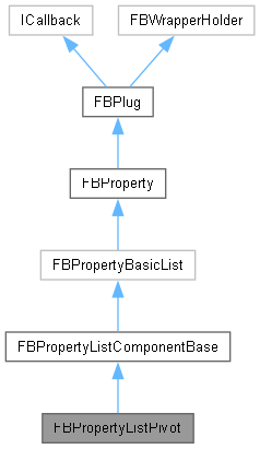

List: Story Clip pivot models More...
#include <fbstory.h>
Public Member Functions | |
| virtual int | Add (FBModel *pItem) |
| Add a object to the property list. | |
| virtual int | Remove (FBModel *pItem) |
| Remove object pItem from property list. | |
| virtual void | RemoveAt (int pIndex) |
| Remove the object at pIndex. | |
| virtual FBModel * | operator[] (int pIndex) |
| Get the object at pIndex. | |
| virtual int | GetCount () |
| Get the number of object. | |
