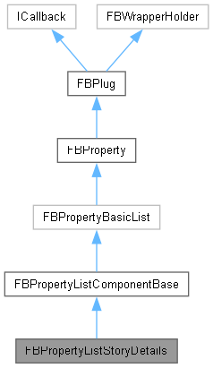

List: Story track Details More...
#include <fbstory.h>
Public Member Functions | |
| virtual int | Add (FBComponent *pItem) |
| Add a object to the property list. | |
| virtual int | Remove (FBComponent *pItem) |
| Remove object pItem from property list. | |
| virtual void | RemoveAt (int pIndex) |
| Remove the object at pIndex. | |
| virtual FBComponent * | operator[] (int pIndex) |
| Get the object at pIndex. | |
| virtual int | GetCount () |
| Get the number of object. | |

| virtual void | FBDelete () |
| Actual destructor for a FBPlug. | |
Static Protected Member Functions inherited from FBPlug | |
| static int | GetInternalClassId () |
| Internal class Id. | |
Protected Attributes inherited from FBPropertyListComponentBase | |
| int | mClassId |
| Class Id. | |
| bool | mParents |
| mParent. | |
Protected Attributes inherited from FBProperty | |
| FBString | mName |
| void * | mParent |
Protected Attributes inherited from FBPlug | |
| bool | mAllocated |
| Contain the Allocation State of the Component. | |
| HIObject | mObject |
| Handle on the Plug. | |
| bool | mSDKComponent |
| bool Plug is an SDK component. | |
Static Protected Attributes inherited from FBPlug | |
| static const char * | ClassGroupName |
| ClassGroupName of the object. | |
| static int | TypeInfo |
| TypeInfo. | |
| static int | mGlobalTypeInfo |
| Represente the Type Index. | |
virtual |
| pItem | Object to add to list. |
Reimplemented from FBPropertyListComponentBase.
virtual |
virtual |
| pIndex | Index of object to get. |
virtual |
| pItem | Object to remove from list. |
virtual |
| pIndex | Index of object to remove. |
