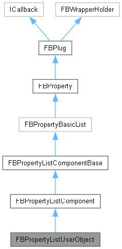

PropertyList: UserObject. More...
#include <fbuserobject.h>
Public Member Functions | |
These classes are under development and may change dramatically between versions.
Definition at line 109 of file fbuserobject.h.
| FBUserObject * operator[] | ( | int | pIndex | ) |
Get the UserObject at pIndex.
| pIndex | Index of UserObject to get a handle on. |
